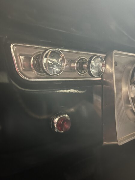

Anyone know what this red light indicator is for? 1965 Barracuda
Thanks
My 64 B body had one. It was for when the parking brake was on.
Maybe ?
Is it one wire and grounded or two wire? One wire grounded might be hazard flashers. Two wire might be parking brake. Otherwise, ??? added, alarm, who knows
One wire. The bulb grounds through the housing.
