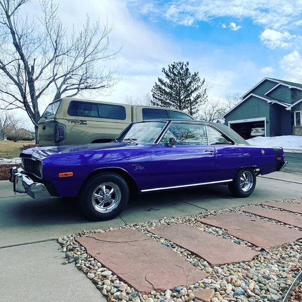

I have a plum crazy purple Dart with a vinyl top. Is it possible to remove the vinyl top and paint the roof without painting the entire car?
Was thinking if I could get the color matched close enough possibly blend it into the existing paint?
