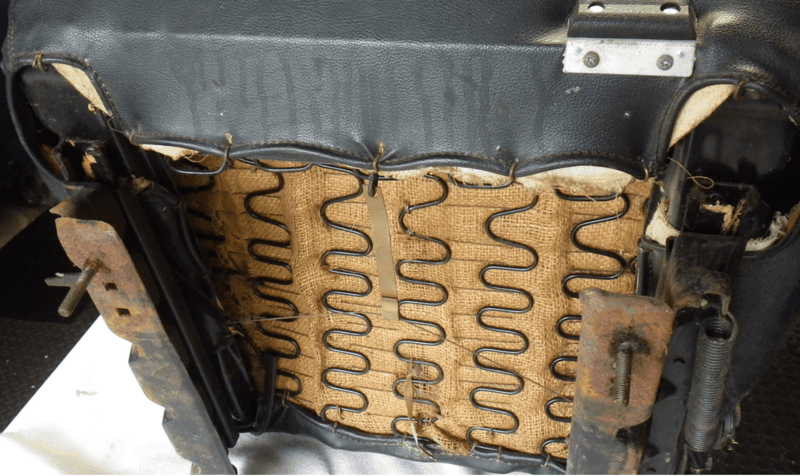

Any tips on removing the bucket seats in a 69 Barracuda? Will they come off the tracks?
If they have original tracks, there are 4 nuts under the floor for each seat holding the tracks down, remove those to lift seat(s) out of car.
The tracks that year also have studs that go up into the seat base, so flip the seats to access the nuts on each stud to remove those.
Easiest, tracks come out with the seat. 4 nuts from under the car. The seat will want to tip back due to the weight while removing the front nuts, you might want to prevent that from happening, JMO.
Your 69 seats with back latches are probably a bit easier to handle than my 67 seats but I'll mention this anyway... Be careful going out/in the car with them. That threaded stud can scar the heck out of a door panel. One of them came through side of a cardboard box and bit my UPS delivery guy too.
