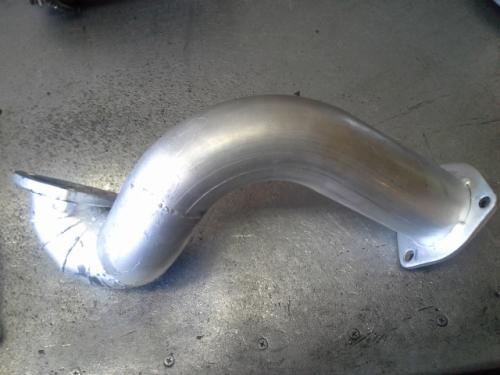

They are Hedman Tight Tubes that have been modified to work on an early A body. They fit quite nicely.
Well, it's all done. Shorty headers installed. Removing the steering column is the easiest way to deal with the troublesome drivers side. Here are some pics. The header by the collector was beat in by previous owner and we kind of put our own touch on it. Not very pretty but it's not a show car.
The down pipes go over the steering arms and right next to the starter. I could have gone under and made it easier but I wanted more ground clearance.

That is some engineering right there! Good work on the "mandrel' 90!
