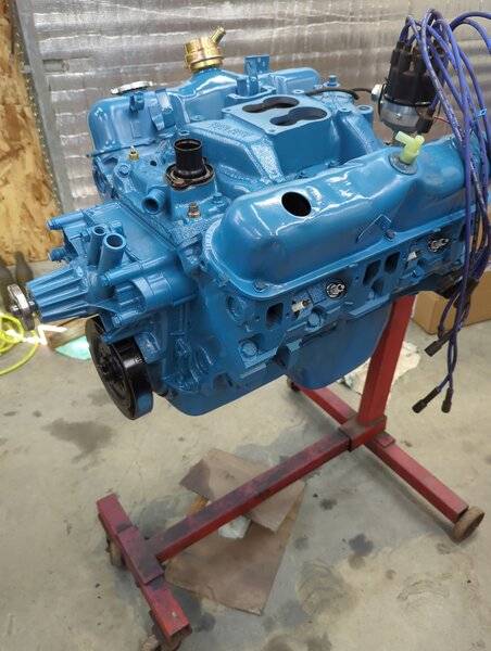

Edit to add, I have a 92 LA 360 block I just assembled. It was previously decked an unknown amount by previous owner to raise compression. I had it decked again to get a smoother finish and after we took off .012" my IC742 pistons only sit .018" out of the hole. So I highly doubt the 92 LA block is shorter than an older LA block.

Thanks for the personal experience shared with the 92 LA block. That's what I was hoping to gain by posting here. One would logically assume that LAs would be the same, but there were other oddities with the 91-92 blocks (oil filter boss in 91, and engine mount pads in 92) that were introduced prior to the Magnum in 93. Some other posts I found claimed either that the deck height spec was revised for these late roller blocks, or at least production tolerances had tightened to the point where the motors were more closely held to the blueprint specifications. I appreciate the feedback, and would be interested to know more about your build process/combination with that 92 block.

I have 1974 LA heads on a 1990 block. I had the pushrod holes enlarged for pushrod clearance, and had the valve spring seats machined for new valve springs I am using the roller pushrods (which are shorter than pre 89 rods) I am trying to gather as much info as I can.
We are taking the block to get dynoed and my mechanic friend figures the deck height will be relevant, I might need different length pushrods.
So after all that rambling, what is the factory deck height of a 1990 360?

Yes mine is assembled, although at the very least I could remove the rocker covers. But I believe with the original rocker shafts and pushrods from the roller block everything should be ok.
I did Prime the engine and put a test pressure gauge on it was reading 65 PSI at 1600 RPM drill speed with 30 weight oil. So I'm thinking that should have pumped up the lifters I turned the crank until I had oil coming out of the rocker shafts on both sides and then turned everything back to zero I was able to rotate the pushrods when the Pistons were at top dead center on compression stroke however there didn't seem much play in the Rockers themselves. Just for consideration.
Curious what effect all machining and such may have.
As stated the block is a roller I'm assuming the deck is shorter than the LA block that had originally came on then the deck was milled .010
And the heads were milled .010 as well so with . 010 off the heads and the deck as well plus 014 shorter deck to begin with that's a total of 034
Not sure if the math is correct.
Thanks again for all the help.
