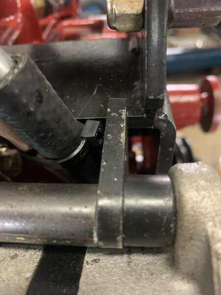

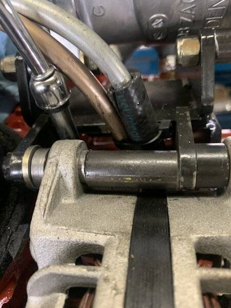

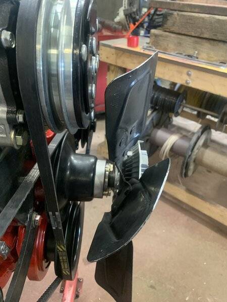

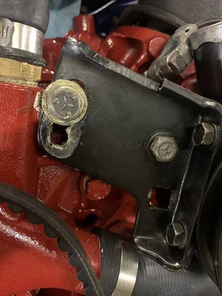

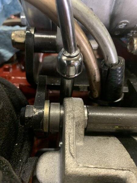

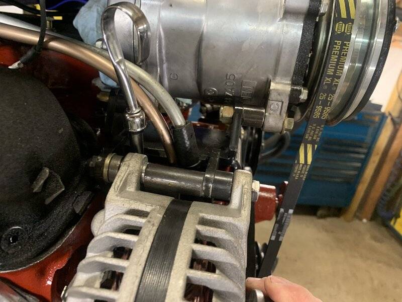

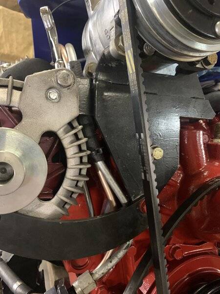

As somebody who has PS and AC and headers on a 273 in an early a body with the factory cast iron water pump the classic auto air brackets for a 318 be prepared for cutting and modifying ALOT! Best to do this on a stand and 360 degree views to keep the pulleys aligned so you don’t throw belts.
You need to make a lot of spacers and most of the bolts in the kit don’t fit the cast water pump. If you swap over to the aluminum water pump then the front cover needs to be swapped along with the proper pulleys. It can be done. Just be patient and take your time.

Can you post a few more photos of your setup so I have a better idea of what to do?

The Classic Auto Air brackets come from Bouchilon (BPE) so don't pay CAA's mark up. (my brackets had Bouchilon printed right on the bracket). If you are using factory AC pulleys DON'T use the Classic Air/Bouchilon brackets that put the AC compressor and the Alternator on the same belts. The grooves are misalligned and you will only be able to use one belt instead of a pair - squeal city!!! I spent a lot of time finding pulleys and spacers to move the crank pulley, the alternator and the power steering forward (while keeping the fan in the same place to use twin belts on mine. You can't move the compressor back since it's already right up to the thermostat housing, so everything else has to come forward.
