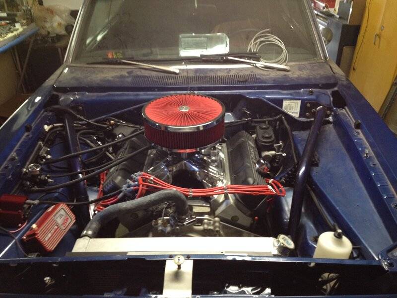

I installed my 440 using Schumacher motor mounts and shims. Installed Schumacher headers with manual steering. I had no problems at all. My motor made 500 HP on the Dyno. Car ran it fastest time of 11.35s. It will average in the 11.40s depending on the weather. Yes the TTIs would make more HP, how much is the question.
