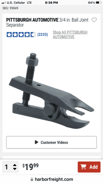

Of course, Harbour freight probably has the right tool for the job cheap. That would be my first choice.
I bought this, works like a champ. Got to be careful, they shoot out like a bullet.
Thanks for all the help. I just went and got the tool. Used a pickle fork to make space for it then put the tool on and they popped right out.
