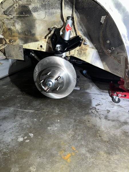

I just replaced my KYB Gas Adjust shocks. They were sufficient for a cruiser but I wanted a high performance shock son I put some Hotchkis Fox shocks on. I will be upgrading the factory sway bar and getting new leafs when I do my 8-3/4 soon.

I recently bought some KYB shocks for the rear of my Barracuda. The gas charge was so great that I couldn’t get even close to compressing them by hand. It looks like they bumped up my ride height about an inch or something like that. They might be just what you want.
