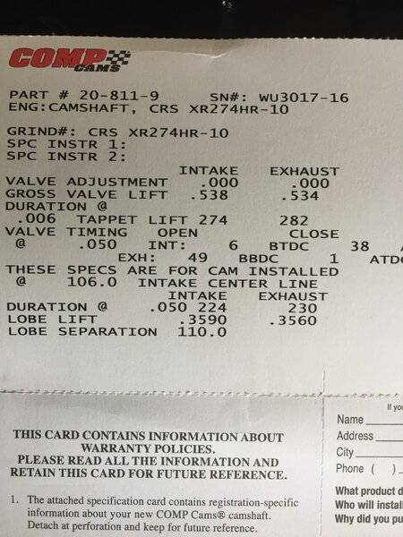

The roller camshaft below - as an example - is a decent area of duration to use on a street car with a minimum of 3.55.
It’ll make power in between 2000 & 5500 with stock heads.
A better higher flowing head will push up the rpm ceiling.
