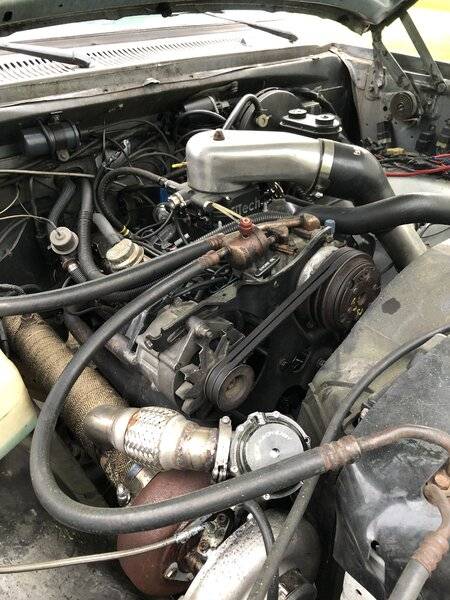

I don’t think it will clear the passenger inner fender. Those look just like the stainless shorty Dakota headers that they’ve grafted a turbo flange to. I tried those Dakota headers once and they are definitely too tight on my Early A. Maybe they clear a later A body. I ended up using a block hugger on the passenger side for my turbo hot side.

I ran a GT45 on my Pre magnum 91 Dodge Ram for 2 years. It didn’t have as much lag as as I expected and made no where near 450whp on 6psi but it was fun and surprised quite a few people for some junk. If you have the turbo already use it, if starting from a scratch take TT5.9mag or subcoms advice at get something better suited for your goals. Also I made both my turbo hot sides.
