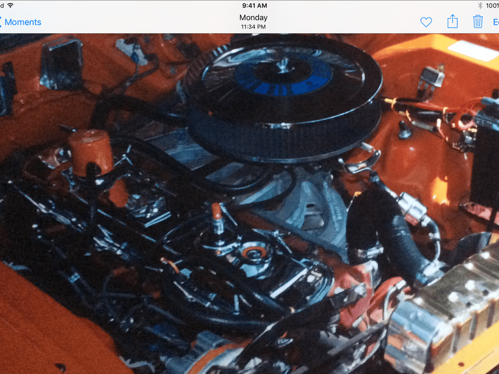

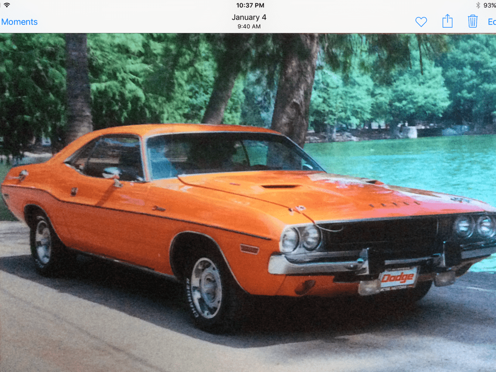

I read this post with interest, I'm one of those that own a SL6 '70 Dodge Challenger, I purchased it from a Dodge dealership, as a trade-in w/ 40K miles on it in 1973. Used it as a daily driver and go to work car up until about 2005 culminating with 562K miles on it now. 3 engines, 2 trans. And 2 rear ends. The last engine I bought from the same dealership I originally bought the car. A '77 model engine, they found it in the mid-west, in a warehouse it was slated for a military vehicle, never had been in a car, this was in 1998. Go-Mango exterior color ( always has been ), 904 (auto) and 8 3/4, 742 case, 3.23 gear set. Black SE interior, rallye wheels. Not one single major accident since I've owned it. It's still a beautiful car, looks as good now as when I drove it off their lot, and I still own it.
Thanks, Al
Thanks, Al
That's awesome. Beautiful car man.!
Thanks for the kudo's Tduff01, from the length of time I've hung on to this car, you'd think I like it some how. No, she's actually part of the family now, SL6 and all. Let me, if I may, give you a few highlights. Built in LA on the first day of production, #113 off of the assembly line. All of the body panels outside of the hood, which is still OEM, (a $55. Purchase) are all OEM to the car. As for mechanical changes, Mopar elect. Ign. (Orange box), HO Accel coil, Super Six set-up, 2 barrel Carter, K&N open element air cleaner, Hooker headers 3 into 1, real dual 2.25" aluminized exhaust w/ "H" pipe, 2 glasspacks, 2 chrome tips. 904 trans. W/ B&M shift improver and Quicksilver shifter. Drum brakes all around, factory 5 speaker stereo system, tuff wheel, SE outside and interior trim. No power anything. As for the hood engine call outs say "225 MAGNUM" I made them up, when hood is up SL6 when hood is down SL6. Thanks again, Al
