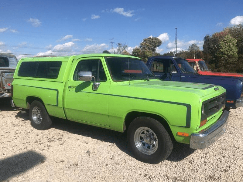

I will post pictures of her as she was when purchased, and as she is now.
The truck (We call her Green Bean) currently
Green Bean when we bought her
