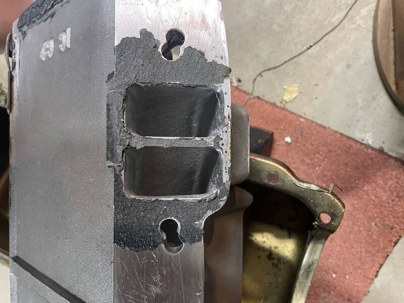

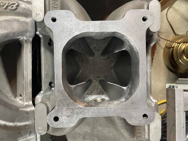

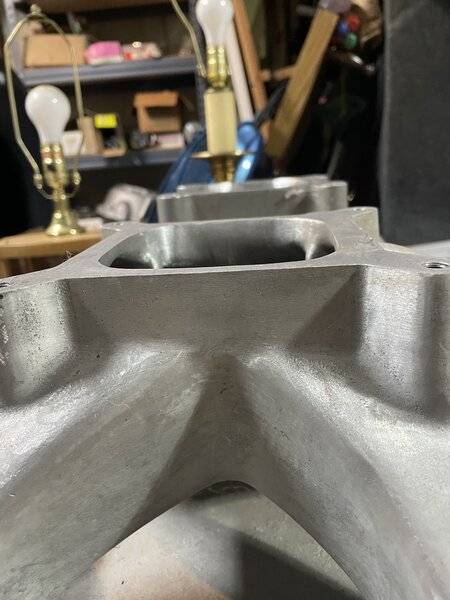

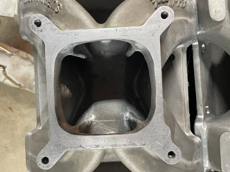

Ok not the best pictures as they are in my house basement where things go to sit unused on a shelf. With poor lighting they both appear to be 6 7/8 inches high from the top of the plate to the carb base. The Indy appears to be a hair taller but then again I had them sitting on a Milidon oil pan mounting plate. The Indy in the house hade the modified mounting holes that I moved so I could use it on my Edelbrock heads. (Long story). Here’s a few pictures.
Greaatttt... thanks man. Much appreciated.
That confirms I won't have to do much modifications to my hood scoop.
