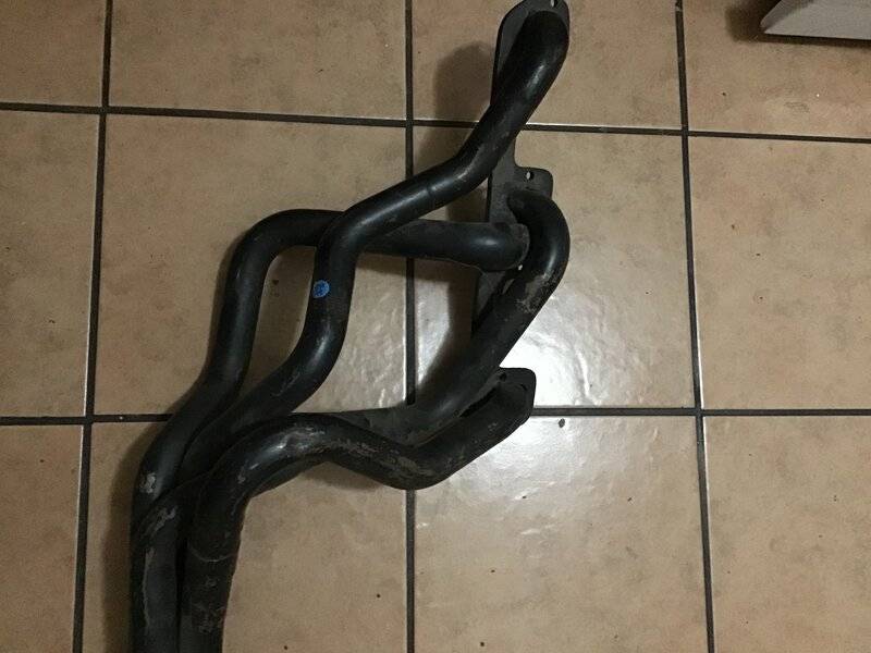

So I got these headers on offer up for $100 he said in add small block headers mopar. I knew right off the bat they weren’t hookers lol

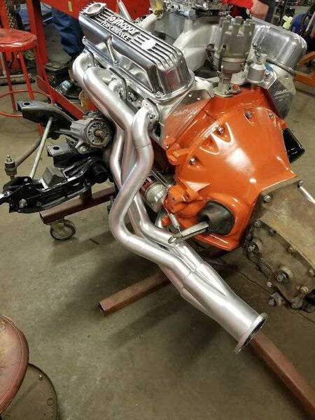

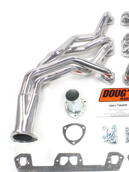

they have one slip tube on the #7 tube the closest picture I found that had a slip tube were these TTI headers I couldn’t find Doug’s with a slip tube online
anyways what do you think?
the jog at the top of the tube doesn't look severe enough, and the 3 & 5 tubes look different but maybe?

Yeah that what I was thinking because the the 3 cylinder pipe/tube goes over 5th cylinder pipe/tube in both photos,

I can’t find any part numbers, I know there is similarity’s but also differences too. Might be a older model?
I don't think they are TTI or Doug's, but if they look to be in pretty good shape, at that price I'd buy em'

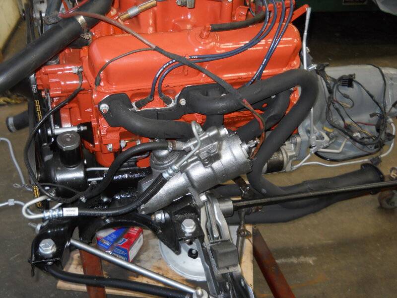

My Doug’s for early A and 273 does have a bolt flange on 5 and a slip on #7 I believe.
My Doug’s for my 340 Demon does not.
while some of the doug's & TTI have the 3/5 cross over, both lack the #5 tube that has the slop sink dump into a hard 90-- which hooker seems to have.
so maybe some early hooker street headers? but again, they, like doug's would be marked.
I’m thinking there some early TTI’s hopefully they fit my 67 barracuda
i'm inclined to agree. hopefully they're right for the application!

Hooker 5303 Abody manual steering 1 7/8 adjustable
they don't look to be cheap hang low headers. if number 7 tube is a slip joint, id guess tti. my tti were step though. here are tti. the old looking headers are headman.
Sorry dudes these headers didn’t fit, that 7 cylinder sleeve that removes its self would not clear in two spots first the brake proportioning valve it would hit there then also the steering column. My motor mounts are new etc guess maybe these were for some other application :BangHead:

Yeah, it sucks but oh well, I wish I could figure out the fitment so I could sell them.
if they fit a van i'd probably snap 'em up off ya.
wish i could help with the mystery but i only have TTI's to compare and contrast
