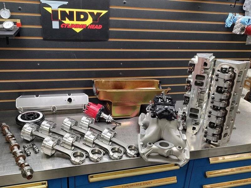

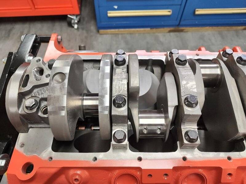

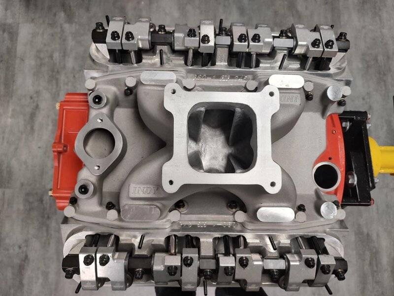

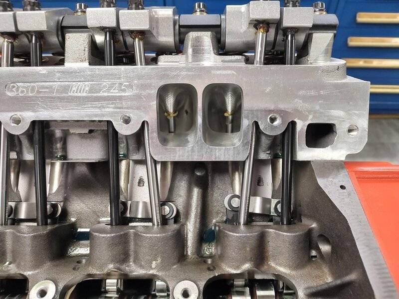

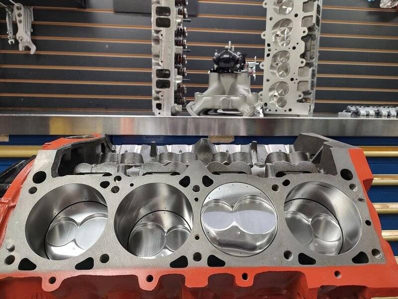

we just finished this great street/strip engine--it is a 422" LA small block--it has a mopar performance R3 block 4.100 bore x 4.00 stroke-- Eagle Specialty Products 4340 crank and 6.123/984 H-beam rods-- Diamond Pistons 12 to 1 with 1.2/1.2/3mm ring pack--Indy 360-1 CNC 245 aluminum heads 2.10 x 1.650 valves 63c chambers--T&D rocker system 1.6/1.6-- COMP Cams roller .740/.730--.282/.286--R110-- BAM Products Roller Lifters with .150 offset on intake lifter--Trend .135 wall pushrods--Indy 1 x 4 intake with port match--Quick fuel 950 cfm carb--MSD distributor-- Firecore Performance wires-- ATI Performance Products balancer-- Milodon car pan-- ClearView Filtration system-- Driven Racing Oil 10w/30--700HP @ 7200--590 Torque @ 5700

what pushrod diameter do they use in such builds? And why is it that some builders use offset in the intake lifter, some say it´s a no go? I think it´s a good idea to straighten out the geometry a little.....or is it done only for pushrod clearance?

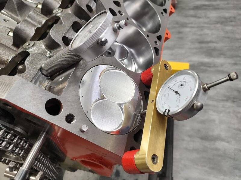

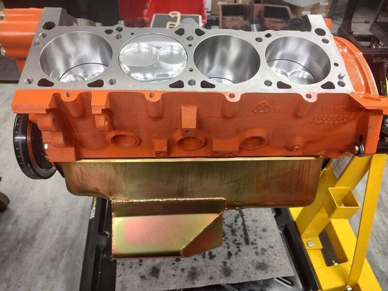

The stated CR doesn’t look correct.
422” with 63cc heads and 11cc head gaskets would yield 12:1 with flat tops that had 3cc worth of valve pocket.
Those pistons look like they’d be more like a -6 to -9 effective dome volume.
Yeah I was thinking the same thing! TQ output is high for 12:1 IMO...
My .02 is.........If the pictures are of the motor being described......... it’s a lot closer to 14:1 than 12:1.
Be interesting to see the spec sheet on those pistons.
