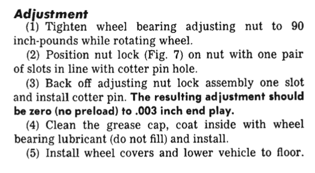

Per the 1973 service manual
Adjustment
(1) Tighten adjusting nut to 240-300 inch-pounds
while rotating wheel. Stop rotation and back off the
adjusting nut with wrench, to completely release
bearing preload. Next, finger tighten adjusting nut
and install lock nut (Fig. 10) with cotter pin. The resulting
adjustment should be .0001-.003 inch end play.
(2) Clean grease cap, coat inside with wheel bearing
lubricant (DO NOT FILL) and install.
(3) Install wheel covers and lower vehicle to floor.

300 inch pounds (which is the correct spec posted above) is 25 foot pounds, so you have the spindle nut TWICE as tight as it should be. Also, they must have some preload, as the FSM states.
The proper procedure is right there in the FSM. The tightening spec is not the final tightening spec, it’s just to seat the bearings in the proper spot. Then the spindle nut gets backed off completely, and then finger tightened so that the cotter pin can be inserted.
The final spec is just .001-.003” of end play, with the nut finger tightened. That indicates no preload at all, because there is still end play.
