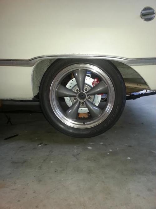

Similar wheel mocked up on the back of my Dart. This was OE off of a 2002 Mustang, I believe. 17 x 8 with 275/40/18 tires. I don't recommend that wide of a tire on that short of a wheel. I'd probably run that tire on a 9" wheel, but it may have trouble clearing.
