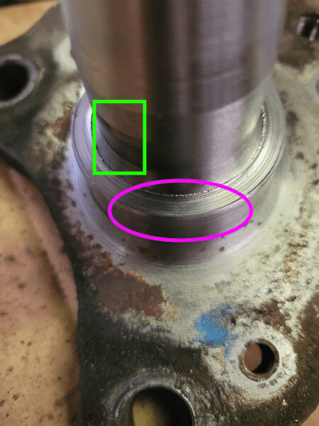

I am assuming the pic attached is what's called spun bearing damage. Can someone tell me what is the cause and what can be done about it? Is the knuckle/spindle considered bad and discarded or can it be used?

This is the worse one I have seen. By that I mean deepest. There is a distinct grove in the metal. The pic is the best I can get.
Not sure. You may be able to fix it with a process called metalspray. It may be that the fix is worse than another one
without a better picture, that appears to be where the inner race of the bearing indexes the pointy thingy.
there is *some* room there and it may be clear of it, but you'd need to fit up a bearing and check.
you may be able to get away with dressing it down and running it.
too loose, too tight, bearing failure due to lack of grease could all be contributing factors.
hows the race in the rotor look? that would probably tell the rest of the story.
The bearings were replaced by previous owner after the damage. No info there. The width of the groove is same as inner race. To me, the inner race is turning and not the bearing to create the groove.

magenta oval: can likely be dressed down, not as important as lime rectangle
lime rectangle: where bearing rides. more important. anything more than minimal imperfection results in swift bearing expiration and probably a fiery death upside down in a ditch somewhere.
Likely from lack of lubricant, the cup seized to the cone and the cone is what spun on the spindle to make the wheel go around.
Its a front spindle that holds the wheel on that steers the car. I would replace it unless you cannot find one. What model car and spindle is it ?

Did the inner race spin on the hub surface? Does the bearing feel loose whey you slide it on the hub?
An old semi truck and trailer trick is to take a center punch and make divots on the surface where the inner race goes. It will raise the metal and hold the inner race from spinning on the spindle. It sounds Mickey Mouse but it works.
This must be a common problem if that's how to fix it. Have found multiple shops for spindle repair.
I'd take it to a machine shop and see if they think they can successfully sprat weld that.
I have had both trans input and output shaft bearing surfaces spray welded, and a diff pinion.
New or different would be preferred.
yes it appears inner race spun on hub surface. Bearing feels tight on spindle.
I agree with TMM, , I've repaired more spindles than I can remember on semi trailers . If the bearing is tight on the spindle thats a good thing. Maybe just hit the collar back there with some emory cloth , and send it on down the road. . Yea , of coarse you have to dress it down and see how it all feels and looks when working it over.
It is easier to replace it, but a machinist can turn down the area and make a sleeve to bring it back to standard.
Agree with Mike. You can also clean surface and add This Loctite after punching. The race will stay put until you warm with a torch if you ever need to change it. This is the problem I think I have but yet to investigate as I posted earlier.
