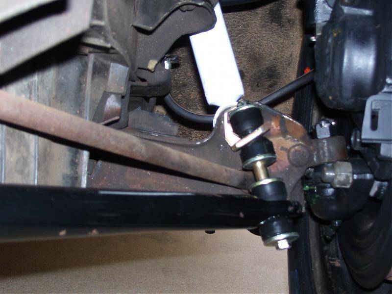

FWIW, you can't use the shock bolt on a 73+ swaybar. They mount to the control arm in board of the strut rod.
Here is a pictur of a 73+ Addco bar installed withe the provided bracket.
