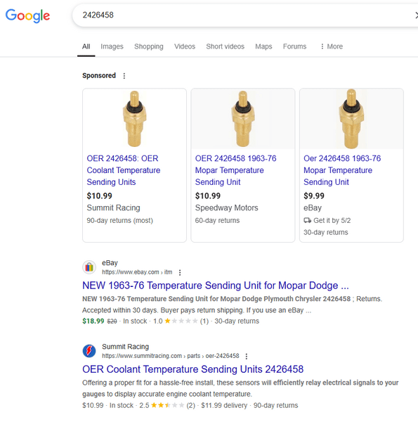

the temp GAUGE sender is 2426458
The temp SWITCH sender is 3744253 (if you trust the hand written note)
Googling the part number has many results and I suspect Amazon or your local parts store will do the same.
