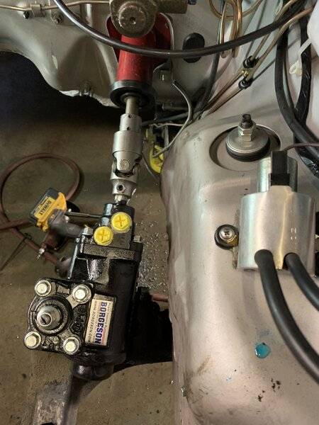

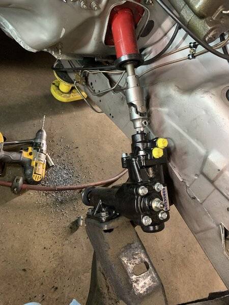

So while the 273 is out for other machine shop items. I decided to try out a new Borgeson PS box on my 66’ Barracuda.
Factory ps car and Doug’s headers and console shift 904. I’m using the factory pump with this box not a sag.
Lucky I have a spare k frame for alignment purposes. Pretty straight forward. A little math, a few times removing column (ugh sratches) but about the size and weight of a factory manual box. Looking forward to the elbow room for the headers. I will keep you posted. I decided not to do a tutorial because if you need step by step - I’m not the guy.
I'll be watching. :thumbsup: Going to swap out the manual steering box when I do the K-frame replacement on the Valiant.
Smart move . I had to buy the Borgeson box because the stock box wouldnt fit with the Dougs headers. I had to message one tube so the coupler would clear. Im using the same coupler you have. Its actually slightly smaller than the factory one. Good luck.
Tim
Tim
Thank Tim!
I got my Doug’s to fit without denting anything but my neck was wrenched twisting around and around -like was up and down and up and down. I shifted my headers toward each other with a wratchet strap and made my connecting tubes (Doug’s to TTI exhaust) so the headers were forced to clear. After a few starts and stops the headers relaxed to their new position. AND without damaging the coating. They never touched the factory box but boy they were close. I checked PS fluid temps after a run and it was 20degree hotter than with the manifolds. I am actually building a ps cooler for the return to help with heat. Hot rodding is expensive!
