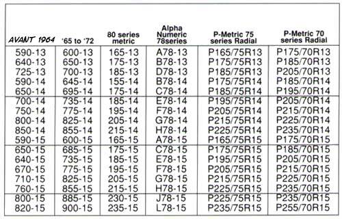

"Most of the pictures posted here are of cars that are not standard ride height"
  • 72-73-Dodge OE tire fitment.pdf

I have posted the charts for tire sizes, rim widths, tire diameter, load range of the different tires. Do some researching with the charts.
For example the 225/60-15 is the same diameter as the 205/70-14 .

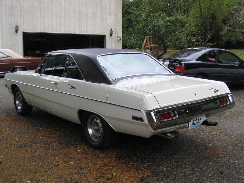

So I have another Dart with the Mopar Performance kit to move the springs in a bit, so I have 7 inch rallye wheels on the back with 245-60-14 tires. Yes this is better, but it also cost a bunch of work and $$$ to do. That car also ran on factory 5.5 inch rallyes for two decades with 245s with no problems before I changed things over, including no abnormal wear that you describe. Between the two Darts, I've run 245s on stock rallye wheels for well over 130,000 miles over 35 years ( before that we mostly used belted bias ply tires :)). I'll take, my experience and that of lots of FABO members over many years and many miles over numbers in a chart based on theory, not long term collection of data, any day. According to your previous post, my experience is supposed to now mean something, right???

for the OP (swingingdart): as you may have guessed this is not the first time 72bluNblu and I have "discussed" this on FABO and I doubt that either of us will ever convince the other. As you requested, I'll take a shot of the Dart wearing 245s on stock rally rims from the back and post it for you tomorrow.
