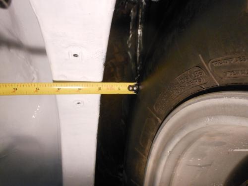

I'm building a 66 Dart that has an 8 3/4" rear.
Stock A-body dimensions meaning the housings never been cut(yet!).
I have done a mini tub, spring relocation and I have 2 sets of wheels and tires.
1st set 15x10 with 6.5" bs / 295/50R15 they are 26" tall street tires (Weld Pro Star Wheel)
2nd set 15x8 with 5.5" bs 28x9.5 slicks (ultra Fast Five Wheel)
Problem is that as the car sits now the slicks hit the inner fenders at the inner fender wheel lip but have all but 3" clearance on the inside frame. See pics below for inside clearance while touching inner fender at wheel well lip

Now another factor in this is a 1 1/2" spacer lifting the rear housing off the rear springs. I havent removed that yet but I will later this week to see if this would take the slicks out of the inner fender and maybe they wouldnt be high enough into the fender to hit at the wheel well lip. I wanted the car to have a very low stance but an 1 1/2" wont make that much of a difference.
So here are my thoughts, I could narrow the rear housing but the street tires dont allow that as they only have about a 1 1/2" clearance before they would hit the inside frame (meaning i could only narrow by 1/2" to 3/4") although the slicks have almost 3" clearance.

Took some time tonight and removed the spacers that were lifting the rear housing up from the SS springs. They were 1 1/2" tall. With these out it looks as though the 15x8" with 5.5 bs and 28x9.5 slicks look like they will be ok. Im going to roll the dice at this point and hope it works out.
Rod
Yes, once i remived the spacers for the rear end housing everything fits ok. I havent had it out on the street but ive got about 3/4" clearance between inner fender and slicks. If you want i can take some pics and send to you.
