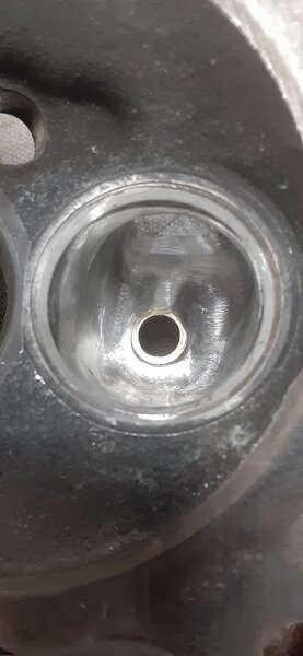

So here is why I ask "TOO MUCH?" With the free (?) time and the heads just setting here till the machine shop wants them I decided to try my hand at porting :eek:. I have never ported a set of heads to the extent that I want these ported. (Keep this in mind if you have some early 70's 915 340/360 J heads you want to unload.) Here is what I have done. I don't know if I have hurt or helped in the production of HP. I will be going to 2.02 In and keeping the 1.60 Ex with new guides, multi angle seats, and a bowl cut that I will blend. This is the Intake, they are all verry similar. TOO MUCH?
Too smooth. 60 grit paper finish at the smoothest
Good to know. I'll do that. There is a lot of back and forth on surface finish. I'm just a welder/fabricator that's always loved MOPARs and still drive em.

Looks great!
Carry on.
Don’t get carried away grinding down the lump in the roof by the intake guide…….. particularly the two ports by the shorter head bolt.
Re-surface finish-
I don’t know what you used there, but 60g can look pretty shiny in pics.
Looks great!
Carry on.
Yup. Unless you want to put a spacer in there.
That’s only for anal retentive jackasses like me.
One other thing……..
My preference is to not port the bowl all the way up to the seating angle of the valve job.
I like to leave a distinct line where the porting ends at the lower portion of the bottom angle of the valve job.
One other thing……..
Yeah, the fella at the machine shop said the same thing. He thinks I'll be ok after the bowl cut. "Just go easy on the blending" he said. The ex is another story, wait and see.
On the ex I do a radius off the bottom of the seat angle, although there isn’t much there to work with on a J head.
Is that to get the bell shape I've seen people talking about. This much porting is all new to me. So yeah, you can teach an old dog new tricks.:lol:
Mind you that I'm doing all this with pneumatic die grinders and several different shapes and sizes of double cut burring bits. And a butt load of HF sanding rolls.
It generally flows better with the radius, and you’re not trying to manage/re-atomize “wet flow”(like you are on the intake).
Yup.
Angles below where the valve seats for the intake……..radius on the exhaust.
