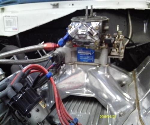

My experience with 440's has been the perf rpm likes a 1" spacer. Mine made 10more hp and 12 more ft/lbs after install. It was a hvh sis spacer. On my current 440 it seemed to help the mid and top end and pulls to red line smoother and quicker.
I am building a new 440 for the street and the Performer RPM is in my plans, I want the motor/power peaked at around 5,000-5,500 ish. I have a 1 inch spacer and can never remember which to use with a dual plane, 4 hole or single hole, think mine is a 4 hole so will try it with the spacer then. Will be selling my Weiand Team G as soon as I get the new RPM in my hands.

The one I used with success was a 4 hole.
