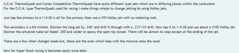

Any TQ guys tried this secondary jet mod ?
I believe there is a typo here as I understand Holley jet threads from Holley are are 1/4-32 threads, not 1/4-28.
I’m not sure but 1/4-28 is a standard size. 1/4-32 is not as as far as I know. I’ve never seen or heard of a 1/4-32 tap.
Take a piece of scrap steel, 1/4 inch thick will do and drill #3 hole and tap 1/4-28. See if the jet screws in.
Sure...I cant remember which forum I saved the text from some time ago. I do remember it was a known carb modifier/tuner - could have possibly been a Super Stock racing forum.
It's 1/4 32. I JUST tapped a main oil passage plug in a slant 6 to accept a Holley main jet.

I think this SEC / Holley jet mod is done by the Super Stock guys. The mod the rear jet and emulsion tube / Hi speed air bleed to suit and also retap the PRI jet thread to Holley size to run the Holley jets.
On the PRI side after the jet mod they also lose the metering rods and tree and jet accordingly.
I'm surprised no one has tried this mod - guess I'm gonna be the lab rat to give it a crack haha.
