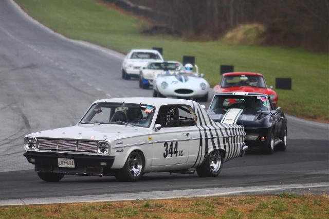

Somebody noted that people were running updated blocks and other parts. Yep the TRULY correct parts are getting WAY too rare and expensive to use at the race track. Why risk an OEM K-code 289 block when you can get a much tougher FMS Boss casting and reduce your chances of cross ventilating in in the braking zone for turn one. Nothing quite like trying to haul a car down from 150 MPH after you've covered the tires & brakes with mix of hot oil and water. Same reason I'd use a replacement 340 block if I could afford it. Same goes for cranks, rods, pistons, and valve gear.
I like and observe the HSR rev limit rule even though my engine (0.045" over 318 ) is too big to run with them. Combined with good parts, that assures a lot of track time between rebuilds.
attachment.php
Dave
