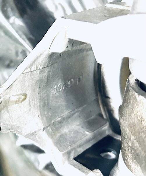

I’m trying to identify these aftermarket 340 pistons from a 30 year old build. the casting number is 1029p . I had the short block rebuilt when i was in high school. I don’t remember specs . I remember the guy taking me into lowering compression ratio to run pump gas. Probably because i was a broke kid who couldn’t afford new forged pistons at the time had something to do with it lol. If anyone can identify these pistons that would be awesome, Thanks!
Appears to be the stock cast late 72 and 73 low compression piston.
I know they are not stock because i had it bored .30 over. i’m trying to figure out the brand maybe the specs. I’m trying to decide if i want to open the can of worms of changing them out forged stock style pistons for my 69 340.

Stock replacement +.030 cast pistons. Looks like it could be an old Sealed Power number.

They are stock STYLE. The fact they are .030 over means nothing except for their size.
ok ,thanks for the help. I am planning on running the stock x heads . I’d like to go back to 100 percent stock but i’m not sure how it will run on todays pump gas. we have 93 in illinois mixed with 10 percent ethanol.
Could be stock replacement badger or sealed power.
Those typically net around 8.5:1
That number doesn't show up in my 80s vintage TRW catalog.
As others have said, sealed power, or badger.

It will be fine with those pistons, because these engines always measured lower on compression than they were rated. It will be in the 8.5-9:1 range.

Measure the compression distance. Center of pin to top of piston. I have seen "hybrid" 340 pistons that have four valve reliefs like the low comp pistons, BUT, have the comp distance of the 10.5 piston.
