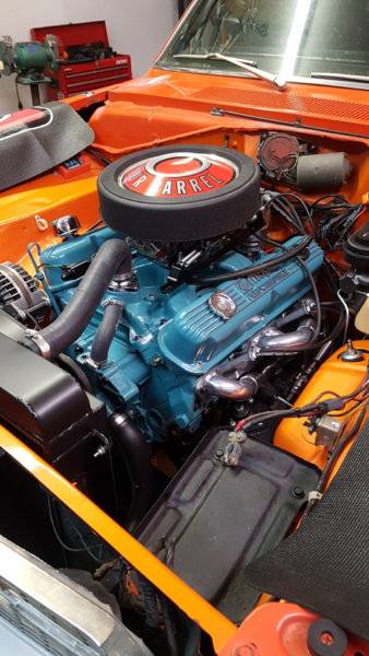

Here are mine polished. In grand scheme of things a month isn't a great deal of time. Get the ones you want or you will always be disappointed with your decision.
