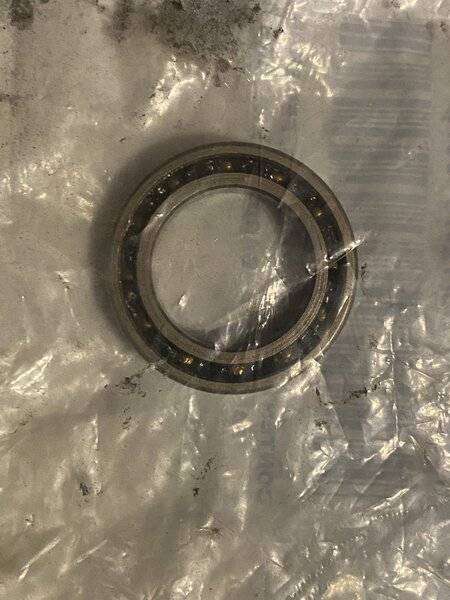

I have a Gritty, Squeaky Noise at the Steering Wheel on my 3-on-the-Tree Column.
I'm Doing a 3-Speed to 4-Speed Conversion this year So,
I bought a Floor Shift Column and it has the same Bad Bearing in it...
Where do I source this Bearing and What is it called?
The last 2 I had, I removed from the rubber isolator. Rinsed them out really well in lacquer thinner, blew them out with compressed air, then applied some fresh aeroshell 22 synthetic grease to them. Worked just fine. Most of the time the old grease is dried out and there is dirt stuck in them.
