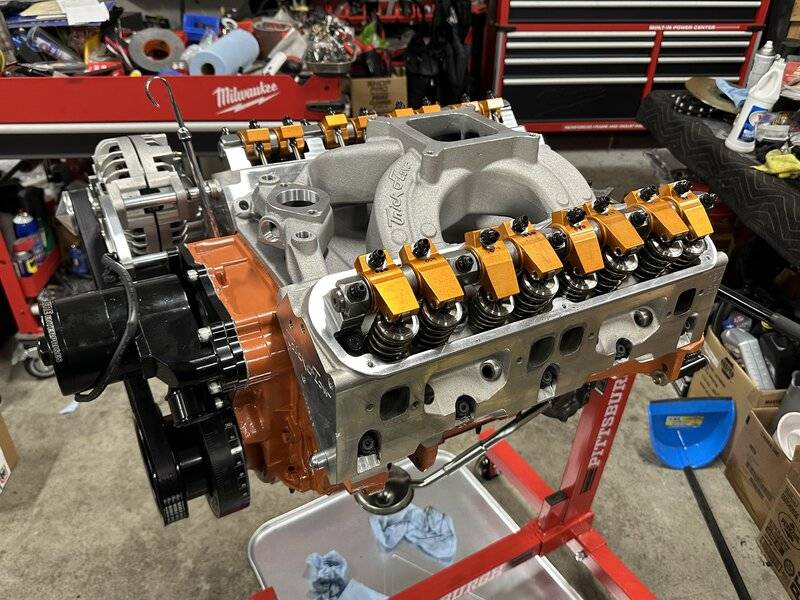

valve adj. on engine while on engine stand before. start up

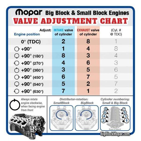

Get a Mopar Performance Valve Lash Adjustment Chart. Once you have oil pressure (priming w/o running) adjust the rockers until you can just spin the pushrods with your fingers. This will put you very close the final adjustment.
It's much easier for "ME" to adjust before they get oil pressure. That way you can actually feel the preload.
Since '66 still used solid lifters from the factory, I'll assume you've converted to hydraulics; and since you're asking about setting lash (actually, preload with hydraulics) I'll assume you retained the adjustable solid lifter rocker arms. I'll also assume you got custom pushrods of the correct length (solid and hydraulic lifters use different length).
Prime the engine, and then adjust the rockers so there is just zero clearance. Then give the adjusters another 1/4 turn.

Need this printed poster sized and laminated so I can hang it on the wall.... lol
Well, it works good for mild to moderate camshafts, but the bigger they get, the more skewed that chart is.
