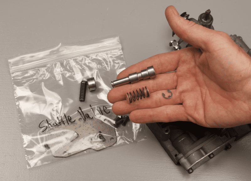

Do your parts look anything like this?

When I took the shuttle valve assembly apart, there were two of the small circular plugs shown on the left stacked on top of each other. Under those was the black spring then the longer shuttle valve.
Interesting. The valve in the VB does not have a spring outside of the casting nor does it have an E clip. That setup is likely why there is no 2-3 shift until I lift my foot from the gas. Thank you for the explanation/diagram.
