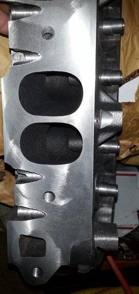

I'm not sure about the closed chamber thing. The reason I was asking about the angle is a set on FB that have what look to be open chambers and are 48 degree as seen below. But the open chambers are probably only about 65cc? I remember reading about 47cc and 55cc closed chambers. Anyway, they won't work for me but now it will be a little easier to weed through the opportunities for me.
Is it just me, or is there some port limitation from the pushrod holes in the 48 degree heads?
One other difference that is not easy to see visually is the 48 degree heads have a 15 degree valve angle where the stock and most other aftermarket heads have 18 degree valve angles. You will need to take this into account for piston selection or measuring of piston to valve clearance. Fly cutting the pistons to 15 degree eyebrows may be needed with 18 degree valve angle pistons.
