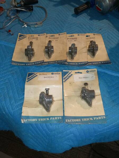

I have almost 3 sets of rockers most are new
Shafts are Harland .180 offset From Mancini
I will have to order pushrods soon surely someone will make a set compatible with these old relic rockerarms

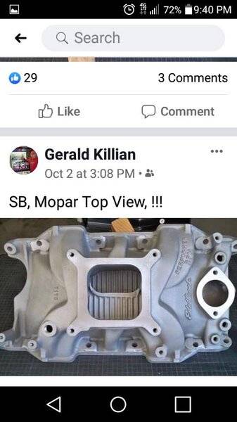

any pics
Ten 4
Good advice luckily mine came in packages and then from a W2W5 expert I totally trust again thank you for info
That reply was not directed at you but to the OP in response to the first post after the thread was made.
:thumbsup:
Nope, no pictures. I sold it when I got a dual plane manifold a long time ago.
the w2 econos i thought uses stock valvetrain, thought thats where the econo came in?
Nope. The intake rocker arms are different. The econos have pedestals case into them. Still need different shafts for the oiling too. Most of them have the oil holes drilled in the wrong place anyway. Nothing econo about them really.
Plus if I remember correctly there are two different econo heads. One long valve and one short valve. Either way you need the off set rocker arms.
