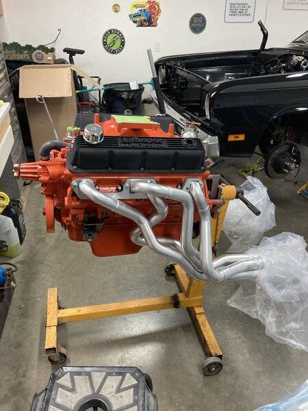

I did a 70 with a later spoolmount k member and a 727.
I added an electric fuel pump and had to grind some ribs off the block to make the la headers fit.
I used a 90 degree oil filter adapter and knocked the locating tab off of it so I could turn it for best clearance.

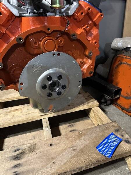

What you are attempting is pretty much a straight up swap and really about as easy as it gets. They came with small blocks and the 360/5.9 is no bigger in size than any of the others. You can run any of the transmissions you want - 904, 727, 3 speed, 4 speed
BUT-
Be aware of the difference in the 5.9's balance.
It takes it's own flexplate or flywheel, which in general does not interchange with any other LA engine (or the 5.2 Magnum either, for that matter).

Yeah I ran into this with a magnum based motor recently. If he decides to go 904 you gotta pay $$$ for a flex plate. I tried the stock magnum flexplate but it wouldn’t fit my PTC converter. Something for him to keep in mind if he is going with an aftermarket torque converter.
And that will also depend on whether EFI is retained- then the stock flexplate MUST be used for its crank sensor slots.
I didn’t know that, thank you for the info. You’d have to probably run a stock converter in that instance, of find a manufacturer that makes a converter that works with a stock FP.

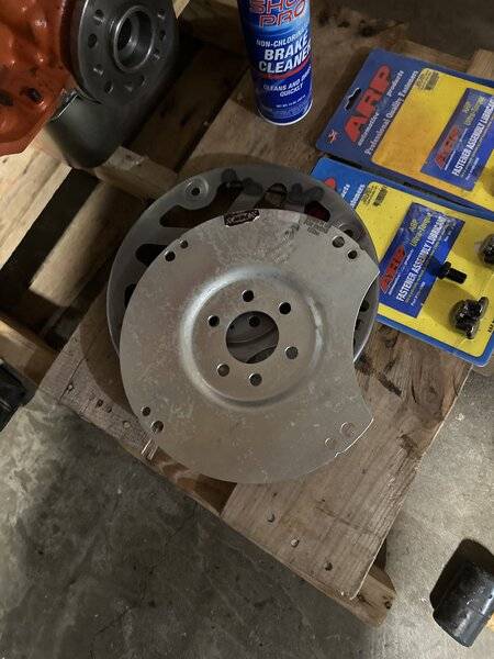

I put a 5.9 in my ride w/a 727 using a B&M flew plate designed for this balance of the 5.9 and a zero balance converter.
Is that a "904" thing or a PTC thing? I've used the same flexplate for both 904 and 727's
I think it’s because it’s their higher end/race 9.5”. It’s close to fitting, it could fit if you beveled the crap out of it.
I assume that PTC designs this converter with an aftermarket/sfi flex plate in mind. Just my hypothesis as I bought the converter used and then the problem presented itself.
If I’m totally honest I wasn’t aware that the magnum was different from the LA in that regard, so it’s been trial and error for me.

You must have bought it a while ago to say the least. They’ve been discontinued now for some time. I also have the proper B&M flex plate for the magnum swap. I think the old B&M part number is 10242. This is the one for the swap.
They haven’t been available for a while BUT Mancini says they have one. Not sure who the maker of it would be. Mancini Racing - Balanced Flex Plate
They also list one for magnum to 904 trans

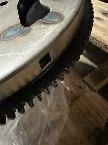

I had a conversation with Mancini Racing and they verified they are offering the Magnum balance offset flex plates. They are having a local company modify/add the offset notch. They did not have one on hand when I spoke to them so I have not seen one in person yet. If ordering one, make sure you are very specific that is is 5.9 Magnum balance you are seeking. This is a new offering to them and the salesmen on the phones may not be fully up to speed on this yet.
