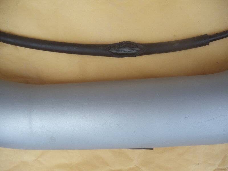

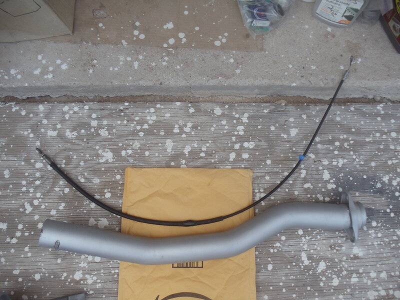

A local (at the time) general repair shop originally installed the 2.5 inch full TTI exhaust system (using stock exhaust manifolds) about ten years ago now. Although the factory clamps hold it up right against the floorboard, nonetheless the transmission parking brake sprag control cable burned through thanks to the fat TTI driver's side head pipe.
I had a spare (used) cable so I went about adding some hi-temp silicone covering. Now the interference is even worse, with the head pipe actually touching the cable/silicone cover. I will need to route the cable a couple of inches further away. I saw no warning in the instructions that TTI provided and, after it was installed by someone else, I was not aware of an interference problem at that time. So buyer beware.

Can't remember what the frame looks like under there. Could you route the cable out and back in to keep it away from the exhaust pipe? How's the motor mounts? You could use a sheet metal shield instead like they use around the master cylinder and brake lines on some Mopars.

If I remember correctly I had a good 1 inch space between the pure silicone tubing (heavy wall braided) and the exhaust. I was really surprised when it caught on fire and even more surprised that it's extremely hard to extinguish. Once it catches on fire it bubbles and melts and drips and sticks to everything. I will never again use it near any high heat source on my cars. Maybe a fiberglass sleeve or a sheet metal heat sink/shield (which is what I ended up with)???

Any custom installations require close inspection for proper clearances. TTI does a pretty good job of making their headers fit the application, but it is still up to us to verify fit & clearance. Glad you are working on the fix before something really bad happens!
Update: I could not remember which H-Pipe side was driver and which side was passenger.
I called tti today and found that right and left are actually stamped into the pipes on each end. That makes it easy to figure out. Sure enough, even ten years later the stampings are still very clear and visible.
