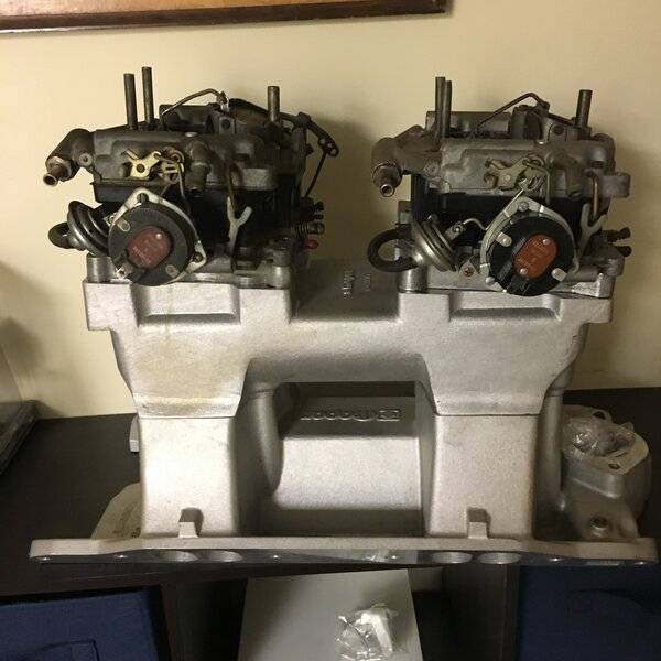

Wasn’t someone looking for a W2 intake.

Not mine
I remember someone was looking for a "cast iron W2 2bbl." manifold- couldn't quite make heads or tails of that one.
We had one of those for a circle track engine about 30 years ago.
It was kind of a sham.
It was nothing but a pre-EGR 360 2-bbl intake with relocated bolt holes to line up with the w2 mounting holes.
Still had the standard size and shape intake ports, and came with an instruction sheet that basically said, don’t worry about the ports not lining up…….it makes no difference.
I wanna say it was like $450 back then.
