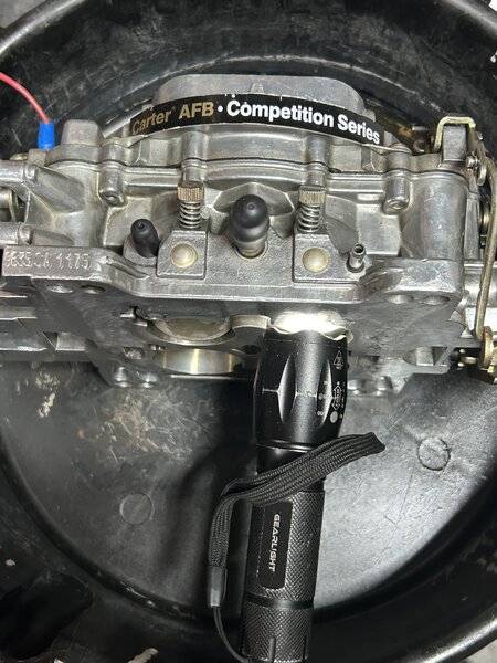

I think you are using to ported nipple . The manifold port is a straight through hole .
You can see the light from my flashlight shining through the port.

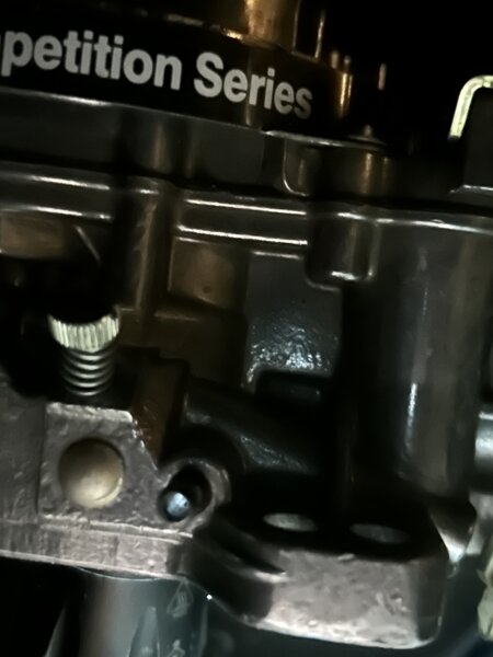

Is this where a slot should be for that port nipple?
^^^^^^^^from a 9635sa on Ebay
a 1406 eddy..........
It is on an eddie. Horizontal slot. What is the story on that pic?

It appears that the marine versions do have different vacuum ports .
Can you post a picture of yours ?
