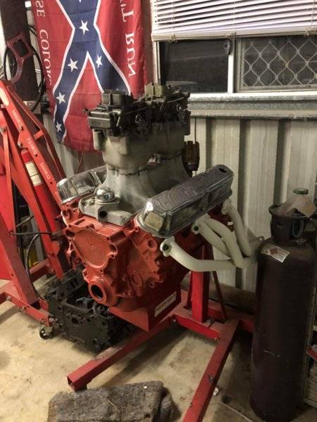

Now the guy offering me his old tr5 is asking $450 (AUS)+ postage, I've included a pic.
That intake has the taller top piece wish is realy designed for higher rpms,sorry i cant remember the actual rpm range but if tunnelrams are hard to find for you localy it will probably work fine anyway,you can always find a lower edelbrock TR top from either a mopar or chevy tunnelram at a later point and just swap the top piece,the lower top piece is the one you can see in Rumblefish post.
