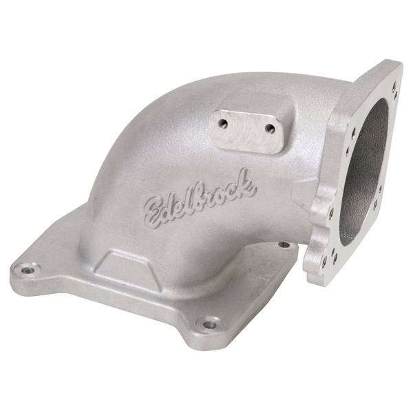

Thats what I'm going to do. Make one. But I know what piece I want to start with.
