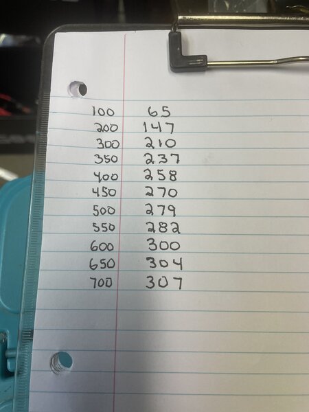

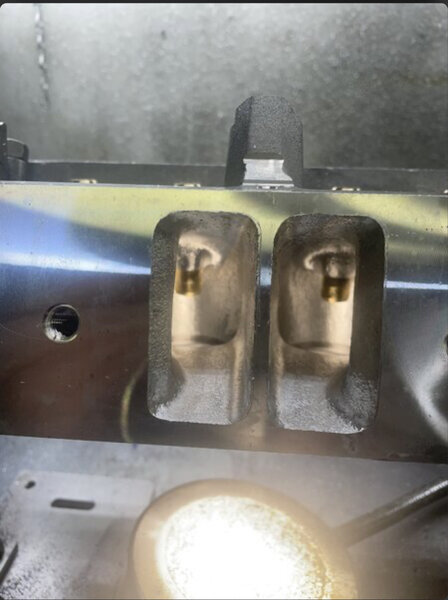

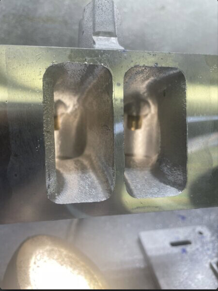

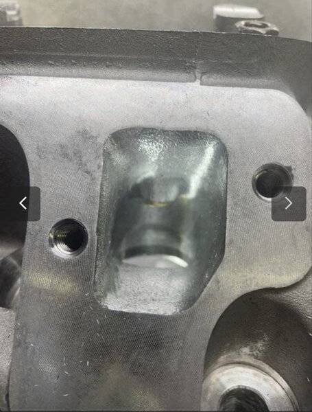

After struggling with a couple smaller chamber heads my target of [email protected] has been either super hard to hit, or impossible to hit. This customer said no rules and Liberty Pro (2.055) valves which flowed some nicer numbers down low than Ferrea valves. These pictures were before the heads were finished but give you an idea.
After struggling with a couple smaller chamber heads my target of [email protected] has been either super hard to hit, or impossible to hit. This customer said no rules and Liberty Pro (1.055) valves which flowed some nicer numbers down low than Ferrea valves. These pictures were before the heads were finished but give you an idea.
You are talking about 2.055" intake valves, right? I assume 1.055 was a typo.
Great numbers, should make for one happy customer.
