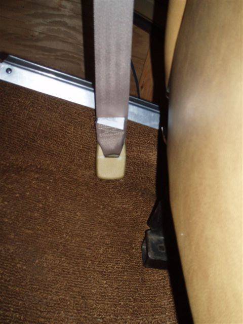

Thanks. I sure picked your brain a lot before ordering these, howevrr i am confident i made the right choice. BTW what did you use to cover up the ends that were mounted in the floor, or did you leave the bolts exposed?

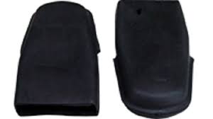

I am looking at either repop C body or B body rubber belt end covers for where the belts are mounted in the floor on either side of the seat. The plastic scabbard that the buckle end is supposed to be in will just scratch the heck out of my seats side panels, so like you, i dont plan on using those.
