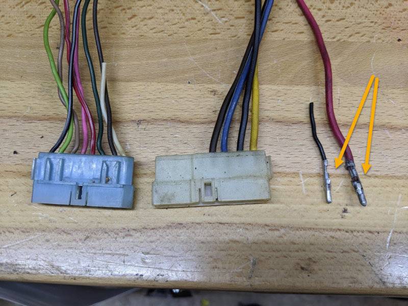

I am rewiring a 74 Duster. Built out a new panel and all new wiring but wanted to use factory style connectors to connect to the Steering Column Connectors.
Trying to find the Male Pins. Looks like two sizes. What are these Pin Connectors called and where can I buy them?

The Molex Pins came in today. I got the .093 14-20 AGW Molex Pins and .063 18-24 AGW Molex Pins.
The .093 Pins do fit the Smaller Female Connectors in the Turn Signal harness but are a little loose in the housing. The .063`s Are just too small for anything.
More research and it looks like Mate-N-Lok Connectors may be a better choice than Molex. These look a lot close to what was used for the Ignition Switch Harness Connectors.
https://www.te.com/commerce/Documen...shENG_CD_350922_Y3_baseFilename.pdf350922-3
Getting these ordered now.
