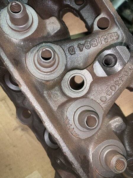

V24x2 Well-Known Member Joined Nov 28, 2015 Messages 405 Reaction score 256 Location MOTORCITY Apr 22, 2023 #1 Hello all engine builders, could you please enlighten me on why every valve guide has this machined notch into it? Same place, all 16 guide tops. 1969 X heads. Thankyou in advance!
toolmanmike Moderator and forum fixer Staff member FABO Gold Member Joined Jan 18, 2006 Messages 88,696 Reaction score 103,674 Location Office Apr 22, 2023 #2 The guides have been knurled. That little notch is for the knurler to start it's travel.
V24x2 Well-Known Member Joined Nov 28, 2015 Messages 405 Reaction score 256 Location MOTORCITY Apr 22, 2023 #3 Ahh Thankyou. I did see the knurling down inside, now I know! Thankyou again!
toolmanmike Moderator and forum fixer Staff member FABO Gold Member Joined Jan 18, 2006 Messages 88,696 Reaction score 103,674 Location Office Apr 22, 2023 #4 That kind of knurler uses a tiny cutter wheel like a glass cutter wheel or like a tubing cutter.
