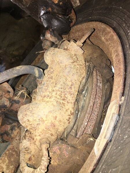

Do you have 4 wheel drums or front discs? If you're not sure pictures of a front brake with the wheel off would help identify what you have. If you don't know the difference, you may not want to tackle the rebuild. Be aware that your car probably has left hand thread lug nuts on the driver side.

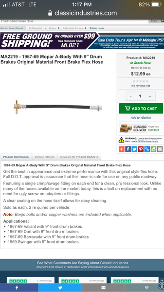

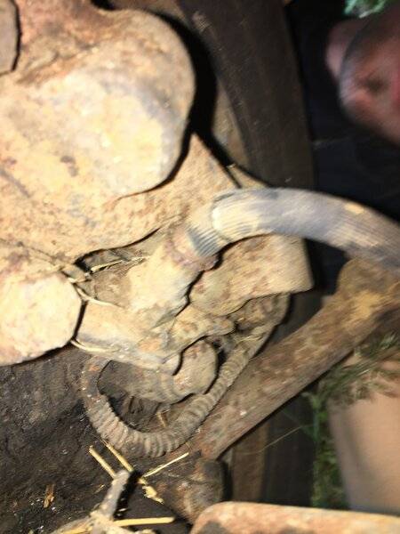

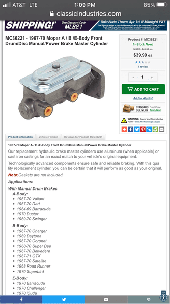

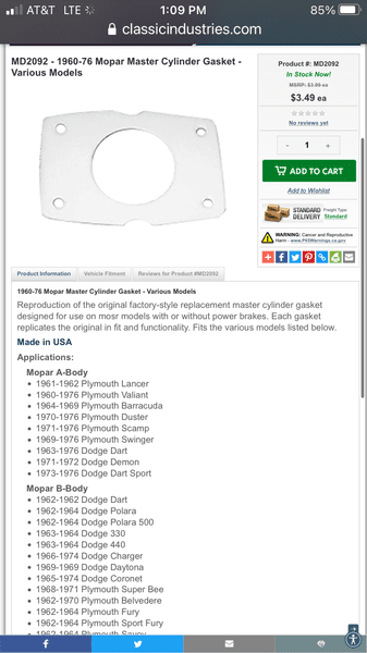

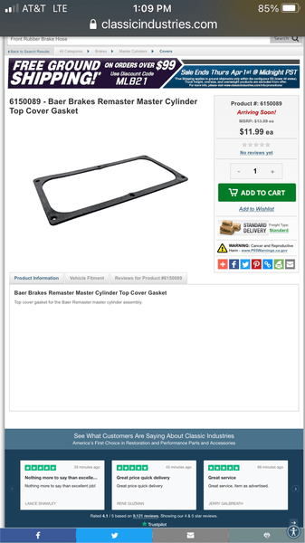

so i have to get two front brake hoses, both those gaskets for the master cylinder since i think it doesnt come with them, the master cylinder, and the steel front brake line set. i think i have disc brakes in the front cause that thing i took a pic of looks like a caliper to me but im not sure. this product says its for a bodies with front drum brakes though but it looks just like the rubber hose i took a pic of. i snapped a photo of both ends of the hose thats on there to make sure.

Pic shows kelsey-hayes front disc brakes. They are factory brakes. Kelsey-Hayes made them for Chrysler and Ford. So you need hoses and master cylinder for disc brakes.
Those calipers may need rebuild or replace. If you use a c-clamp to push those pistons back into crusty bores, they will stick and you may struggle to get them out again for rebuild. How bad they look on the outside doesn't define what they look like on the inside but... go ahead and rebuild them would be my plan.
A replacement maser cylinder will come with the rubber gasket under the reservoir cover. The white gasket between master cylinder and firewall is simple dense foam same as packaging material you may have. Make that gasket yourself to save a few coins.

The master cylinder shown here is not really correct
The disk/drum master cylinder has a larger front brake resevoir.
If your car has that master cylinder, rebuild it.
They have become very difficult to obtain.
Rebuilding it might be as simple as replacing the seals or it might have to be sent out for sleeving. All depends on the condition of the bore.
An alternative is to buy a aluminum master cylinder. "Dr Diff" is a reputable source and I assume he'll ship to Maui.
Be careful of the plastic resevoir - some friends had mentioned they sometimes leak at the bottom seal. They were a production item - I dont think its a major issue - just a weak point.
1968 is a transition year for drum brakes. be sure to reference '68 and earlier when working on the drums.
Front brakes and master cylinders remained unchange. You can reference '67 - '69, and '70-'72 is very similar.
Definately replace the hoses.

That master cylinder may be correct. Description says it is. The early ones with bolt on top looked very much alike. The drum/drum master cylinder had a shallow reservoir. Disc/drum master cylinder casting was deeper to hold more fluid. Hard to see the difference looking at only one.
There's so many companies now that are selling drum master cylinders with the residual valve removed from the front brake outlet, theres a 99% chance that's what they're selling.
According to those Chrysler master tech booklets, only the drum brake masters had castings with the bolt down caps.
