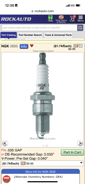

I use always NGK, motorcycle, 2stroke, classic cars, kart and more.
Sometimes you need a cross reference chart from the intermet.
Never disapointed! If the NGK plug fouls, your engine had a problem. Best thing they are cheap too
Needs to be a 5 heat range in NGK, not 4 [ unless the engine is severely worn & burning oil ].
