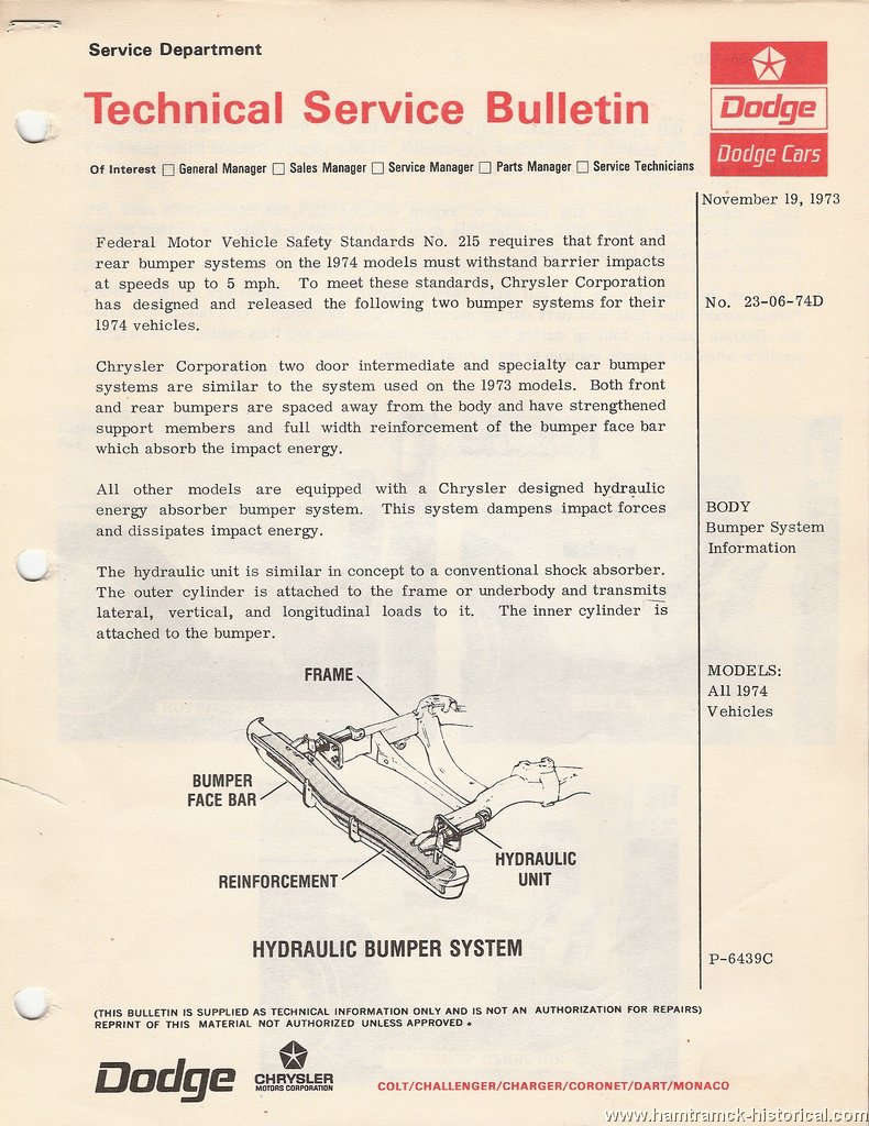

Could the requirements for cars sold in some states be more strict, therefore the 'newer' oil can style mounts? States such as California?
Production started for the ‘74 models with all of the cars at all the plants getting shock mounted bumpers. Then, sometime in mid-December of ‘73 there was some kind of production problem with the front shock mount bumpers, and from mid-December~ish ‘73 to the end of production of the ‘74 model year in July ‘74 the ‘74’s went back to a standard mounted front bumper. Those cars have frame mounts for both types of bumper, so, three threaded holes. The early ‘74’s only have the frame mount for the shock bumper, a single threaded hole.
That also means there are two different ‘74 front bumpers. The design is the same, but the holes for the bumper brackets are in different spots for the shock mounted vs the standard mounted bumpers.
