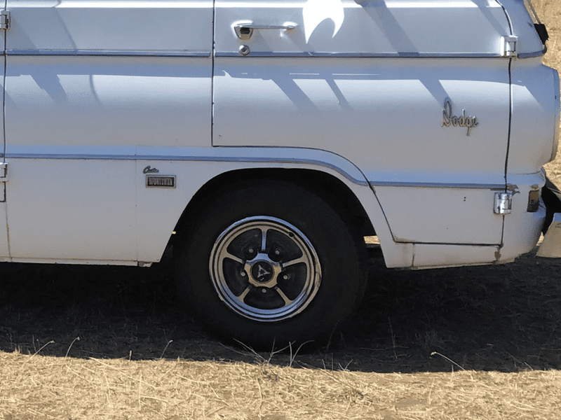

The style on the back of this Valiant are the wheels that I'd prefer....
Were these available on cars with the small bolt pattern? Every car that I have seen with them has the big pattern. I know that the small bolt Rallye wheels are rare.
I'm not one that is married to keeping a car all stock or original but it would be nice to know if this wheel was available on the Darts.

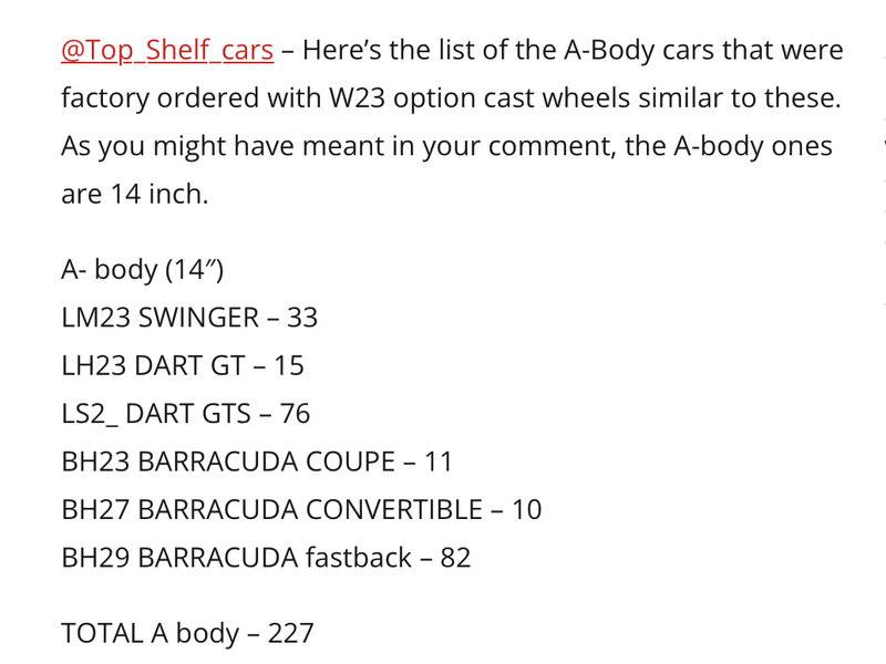

Those Chrysler road wheels weren’t available in small bolt pattern. The 1970 and up rallye rims aren’t that hard to find in 14" and if wanted are available in 15" brand new from a couple different sources but I find that they really look out of place in 1969 and down cars.
I’m pretty sure Kelsey Hayes recall wheel were also Not available in small bolt pattern as well.
Those particular ones almost look like Ford pieces, made in 14 and 15 inch diameter, and they were as others have mentioned never available in sbp. I do know that some of the Ford ones were specific to drum brake applications and will not fit the hub of a disc brake rotor. (ask me how I know)

In this case I think the road wheels (magnum 500 by some) would look good. 215/60r15 is 25.15" tall. Should fit the front ok and fill out the rear better too. Imho
Were not all the oem Road wheels (magnums) 14 inch?? I wonder if they are repoped today in 15s today??
I agree, beautiful wheels!
They were coded w-21 and weee described as road wheels. Most people call them magnum 500’s which I think is a ford thing/description
"Magnum 500" was the manufacturer's name for the wheel that was also sold after market.
The same company (Motor Wheel) also made them for ford and gm...but ford and gm also got 14x7 and 15" wheels :(
