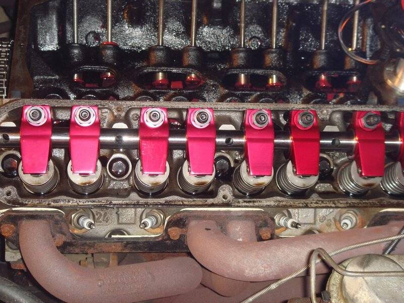

I believe the "Harland Sharp roller rockers" is incorrect simply because I've only seen the orange-ish gold colored ones & the ones pictured in the ad are red. It would be great if I could just pull it apart enough to reseal everything and put it in and drive it until something dies (or until it is replaced with a 408 stroker) So I'm looking at it mostly as

Just in case someone can identify the rollers?
Harland Sharp makes rockers for Mancini. They are red.
If those are Harland Sharp rockers they are expensive on their own...$800-$900 new! There’s a good amount $ in the aftermarket stuff on that 318....
Anyone notice the break-in grease on the cam and lifters or the surface rust below the plugs. These heads look like they were hot tanked at the least and installed and looks like the engine has been setting for a while. The header bolts being bare metal have enough surface rust for at least a few years of humid storage. Consensus; the engine is an unfinished rebuild, I would look at it for its parts value and without taking it apart consider the internals as used.

Yes, I saw the assembly line on the cam there, or at least that's what I thought it was in the pic.

Looks like they pulled a running mill, had the heads freshened up, bought all Eddy Performer stuff new, added some roller rockers, MSD etc. If that's a new T-chain kit as well, there's a bit in new parts alone, new fuel pump $0.00? Really? If it were Perf. RPM stuff, it would be more desirable, but....
Verify the rockers, if they are Mancini/H-S, You've got more than $1,000 in new parts easy all together. It's only worth it if that's what You want tho'. It don't take long for condensate rust to form in an un-heated garage, if short-term(if any) rust preventative is used on stuff from a shop.

The picture of the rockers w/lube were from when he took the heads off, had them rebuilt (stock) and then put the roller rockers, new lifters, new etc. Had pictures of everything he did to the engine as he was trying to increase the performance. The bottom end of the engine has about 64K on it. The parts have less than 15K on them over 5 years. (he has 3 e-body barracudas 1 poor rusty AAR, a 74 that this engine came out of...that's at the paint shop being made into a replica AAR that he can comfortably drive, & a 71) I was thinking he was a little crazy to take a matching engine out with low original miles BUT when he said he was slapping a 440 in it and making it an AAR, well it's hard to argue because most of us would love to be in the spot where we could do that too. The pictures of the progress were making me drool just a bit.
those from HS that Mancini sold/ sells are more like 499 complete with shafts, etc. at least they were about a year ago
